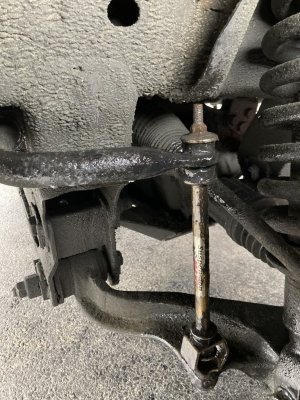

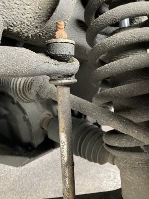

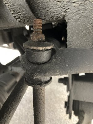

Does anyone else have issues with their front sway bar bushings? I've read of people keep having them snap, but not so much about the bushings. My bar is level and torqued, but I can't seem to get bushings to last.
Have tried 2 different Rough Country setups, stock with BDS extensions, several Moog bushing kits, etc. Bit the bullet and got the Suspension Maxx, and same thing is happening. Have adjusted them twice already. Were fine for a little bit but I noticed a difference in ride lately and sure enough the driver side looks out of whack again.
Could my bar be bent possible somehow?
First pic is pass. side, which looks ok. Others are driver side, can see the bottom bushing now compressed a lot more and can see end link under the top bushing. I know you're not supposed to compress these very much so I don't know what else to do here. I see there's an extra thread showing on the good side...

Looks like your sway bar is on the wrong way. Flip it around. Should be angled like in my picture which would mean yours is upside down.
Yours look mint. I had tried that when I was installing the Rough Country links, but it made them even worse. But you're right, judging by the pics it does look upside down compared to yours. I'll try that tomorrow, hopefully I didn't ruin the bushings already. Thanks!

Reach out to @Nick@GotExhaust he can set you up with suspension max sway bar endlinks. The issue with yours is they were never tightened properly which destroyed them.

I have Suspension Maxx currently. And I tightened them when I installed as per instructions, there were no gaps and I stopped just short of seeing the bushings bulge. It's just after a while of driving this happens (more so on driver side for some reason).

You tighten until they start to bulge. Suspension max sells replacement bushings. In your case go 2 full turns once you see the bushings start to bulge. During oil changes inspection is required to tighten and grease suspension components. Post a picture of the swaybar out. Put a piece of tape on one the drivers side before removing it, and flip it over @crazykid1994 and I will tell you what what to reinstall

What's weird is I don't know when the bar would've been flipped over the wrong way. When I've replaced the bushings I was sure to install it the same way it was removed. Anyhow, a good chance to pick up some new bar bushings as well. Thanks for the help, would make sense for the issues I'm having.

@crazykid1994 sure as **** the bar was upside down like you said, I feel like an idiot! Lol. The only thing I can figure it was flipped when the lift was installed years ago, although I don't know why they would've needed to remove the bar.
The bushings looked ok, but I'm going to order a new set just in case. And I was under the impression the 4x4's all had the 36mm front bar, but mine is the 32mm. Did this change in a certain year or something? Even though I've seen other '11's listed with 36.
