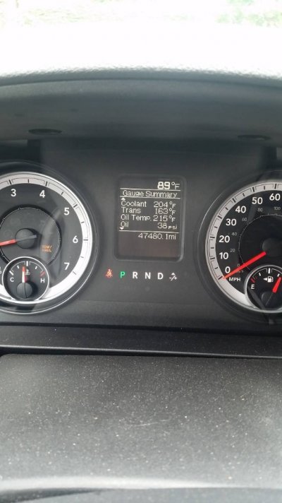

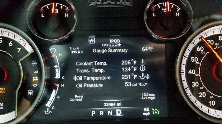

My temps with 5w20 PYB would easily reach 225-230 just driving around in the summer with no load. With Redline 5w30 it struggles to get to 212 just driving around in the summer with no load. Conversely, here are pics of my temps while towing my 4500lb TT over the summer with RL 5w30 in the crankcase. The second picture is towing it up the mountains of NH in October. As soon as I stopped the oil temp quickly came down to 210 or so both times. And the UOA on that oil was the best I've done so far for wear metals.16a12266b89d8eec976a0b4c9277362c.jpg122c70db43a5d7663181978293ff28b8.jpg

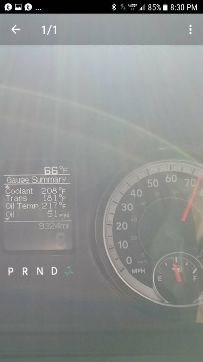

I think the best way is to post your oil type & wt . along with a photo of the instrument cluster while temps are up and doing about 70mph .
Like hemi395 did above .
Pix of mine , after getting home from work and running the **** out of it.

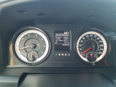

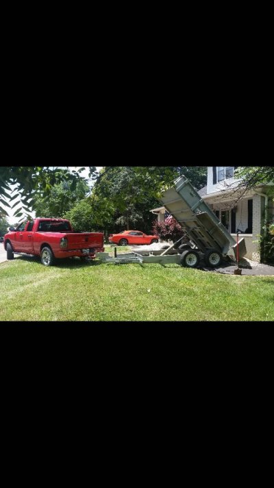

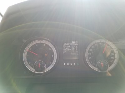

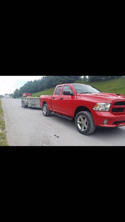

These are pictures of my 5W-30 RL after about 25 miles of driving pulling 7,500 lbs of trailer and rock and sitting at a stop light .
Keep in mind I have the 6 speed xsmn which never gets above 150° unless pulling serious hills or hauling more than 5k .
127b3cea4f724a2f8578c582075812d4.jpg38a420e1b8613b94ced601a1545b7415.jpg61ef7b9db22ae58ffb99d377f93286db.jpg
