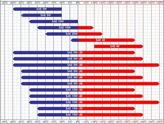

Weight has not much to do with winter rating, 5w20 and 5w30 both have very similar cold start up viscosities, it is when the engine is warm that is when weight matters. I would use 30 weight over 20 weight in 100 out of 100 conditions. Look at the chart, 20 weight is the same, in winter you only concern yourself with the winter rating, the first number in the 5w30, the second number is the weight. If I was to buy a new hemi, every oil change would be 5w30 redline with a RP filter, as long as the formula stayed the same and other ester/pao options didn't exist. 0w30 and 10w30 redline aren't as desirable to the 5w30 imo, but all three are good choices if you can't find 5w30, or you find a sale like right now 10w30.

Yeah, I was just wandering if the 20 wt would warm up faster so you'd have more chance of burning off condensation. Apparently there's not much difference if any at all. It's 68 degrees outside and I just went for a 30 drive and sat in drive thru line for about 10 min and by the time I got home my oil had just got up to 212 degrees.

See chart above post, 10w30 is still good down to -30F, so no reason this wouldn't be a good choice for most locations usa.

I might grab some 10w30 for the summer but I doubt I'd run that in the winter. Plus RL 5w30 is working so damn well in my Hemi I kind a don't want to mess with it...

If you do go with the 10W , just mix it 50/50 with 5W like I do [emoji106][emoji106]
