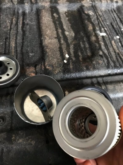

So here’s the video of the cut open OEM trans Spin on filter next to a mobile one of the same size.
Pardon my crappy video taking skills and my blabbering. I think I said the word “flow” about 35 times[emoji23][emoji23].
So the OEM spin on filter has no bypass valve. But the way the anti-drain back valve works seems to me that there is no way there could be a lot of pressure or it would close up the hole in the top of the cartridge. Take a look and see what you tink.
Sent while firmly grasping my redline lubed RAM [emoji231]
Dude, you did a great job with that video.
The OEM trans filter really is an odd design. So if I'm understanding that right, when the fluid goes through the media it has to push that valve up to come back through the center tube?

Forgot to add a picture of the bottom of each filter to show that there is not even a hole in the bottom of the cartridge for a bypass
Wix
OEM
holy smoke, lol. thanks for pointing that out.
If what corey says it true, the flow goes through sump filter first, then spin on filter, there really is little chance of something getting stuck in clutch packs even if the bypass opens imo. I'd litterally be happy if it was just the sump, because that thing is solid.
Yes sir.
After the oil passes through the media the only place for it to go is up through the center tube and has to push that plate up to pass it.
It literally works the same as anti-drain back valve but instead of it being before the oil goes through the media like we are used to it is after it goes through the media

Yes sir.
So it basically forces the fluid to go through the media...

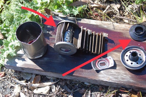

Ok,
I asked Mike for that picture he took a while ago when he cut open his spin on transmission filter. My head was tinkin sometin fishy was going on. Check out the differences between the filter I examined and the one Mike took apart.
This right here is hook line and sinker in my opinion that we should have no worries about running an engine oil filter. The one I examined we all see is a bit different and raises some questions .....but if Mike was to buy a new filter for his trans it would look identical to mine. But look at the one Mike took out ...it is literally an engine oil filter and here’s why.
So here’s a picture of Mikes filter. You can see a few important things here.. look at his anti-drain back valve. It is actually the same thing as a traditional engine oil filter. Now look where he cut the filter open and you can see the center tube. you can actually see through the holes at the top of the cartridge so there is no goofy spraying and plate anti-drain back like in the one I examined.
Now look at mine and see how you would never be able to see through the holes in the center tube if you cut the media off. c7cda0d9fe0e4852562b21dd8b2ef98a.jpg
And look at the seal that i have in place of Mikes Normal anti-drain back vlave
So,
Mike has been literally running a paper engine oil filter with no bypass.
We are all good. IMO
