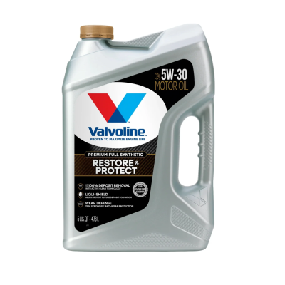

Royal Purple is good oil. I haven't used it in years because I have no reason to. Their best stuff are the HPS and High Mileage oils. The Royal Purple oil sold at Walmart is API licensed, and it's like any other motor oil.
If you want something that cleans, I suggest you try Valvoline Restore & Protect. Afton Chemical formulated the additive package for Valvoline. Initially it was meant to be a long drain interval motor oil, because Valvoline doesn't advertise one in their portfolio. However, during engine testing in their lab, Valvoline discovered that this new additive package removes old carbon deposits and sludge. Valvoline tweaked the formulation so that it won't overwhelm the oil filter when it cleans. It takes three to four oil changes at normal oil change intervals to completely clean an engine with it.
Walmart has the cheapest price for it, and I would go straight for the 5W-30: https://www.walmart.com/ip/Valvoline-Restore-Protect-Full-Synthetic-Motor-Oil-SAE-5W-30/5000131742
