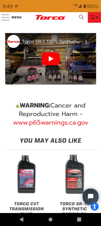

TORCO SR-1 100% SYNTHETIC HIGH-PERFORMANCE ENGINE OIL​
144 a case.
Marketing from torco on this oil...
  • Shear-stable polymers ensure continued long-term engine protection even at high temperatures
  • High solvency synthetic ester technology prevents deposit formation to keep your engine clean
  • PAO base and advanced friction-reducing additives lower operating temperatures and enhance efficiency
  • The proprietary antiwear package protects cams and lifters even at high loads
11.99 at summit.

Oh boy... check this out:
144 a case.
11.99 at summit.
The only question I have is: who blends it for TORCO?
