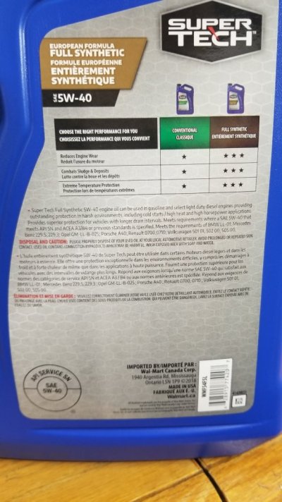

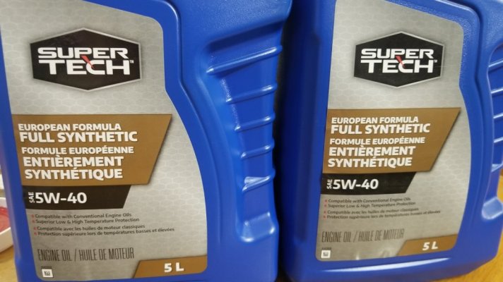

picked up some super tech 5w40 euro for my next oil change in 2k kms. 28.88$ per 5 litres in Walmart Canada
the pennzoil 5w40 euro that I usually buy has been steadily increasing in price recently.
interested to use this oil for the first time. almost warrants a UOA haha
For the HEMI it will work the same as Pennzoil Euro 5W-40. No worries, and no reason to waste money on a UOA.
