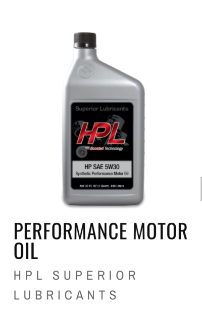

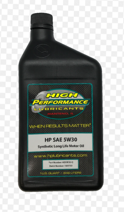

Which one, I don't remember.
HPL in Indiana or HIGH Performance Lubricants in Illinois?

Have to use the second one, black bottle, from advluburication.com. The gray bottle is a different oil (still produced by them but under contract for a vendor).
They are both made in the same plant. The red-label HPL is blended specifically for the power-adder market. It's a streetable racing oil. The red-label HPL is a separate company that uses High Performance Lubricants to formulate, blend, and package their oils.
The green label High Performance Lubricants is their own product. It's formulated for high performance applications, with commercial fleets and long drain intervals in mind. The TBN and resistance to shear is off the charts.
They use two main additive lines that then they tweak for specific products:
1) Everything in the PCMO lineup, NO-VII PCMO lineup, and the BAS lineup, is based on a Dexos 1 Gen 3 additive package supplied by Infineum.
2) Everything in the NO-VII Euro lineup and SuperCar lineup (plus the 5W-40 Euro oil) is based on a VW502/Porsche A40/MB 229.5 additive package supplied by Infineum.
3) Everything in the Euro lineup is based on a mid-SAPS VW504/Porsche C30/Dexos 2 additive package supplied by Infineum.
Now, if you buy the cheapest PCMO, or the most expensive, it doesn't really matter, unless you absolutely need the small advantages that the more expensive versions have: the cheap PCMO has the same cleaning and anti-wear power as their most expensive oils. The difference is that it's blended with Group III. The PCMO Premium is blended with PAO, and the Premium Plus is PAO + Star Polymer. The Star Polymer is about 10% compared to the Olefin Polymer used in the other two. However, the NO-VII is blended with mPAO instead of a Polymer.

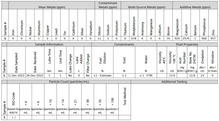

Go with HPL Super Car 0W-40. It's their highest end motor oil, and the most expensive to make, and it doesn't shear. The good news is you can run it all year, without the need to run a thinner oil in winter.
It's a blend of PAO + POE + AN + Infineum Additive Package - it doesn't get any better than this.
Here is a VOA:

That is a nice add pack.......
