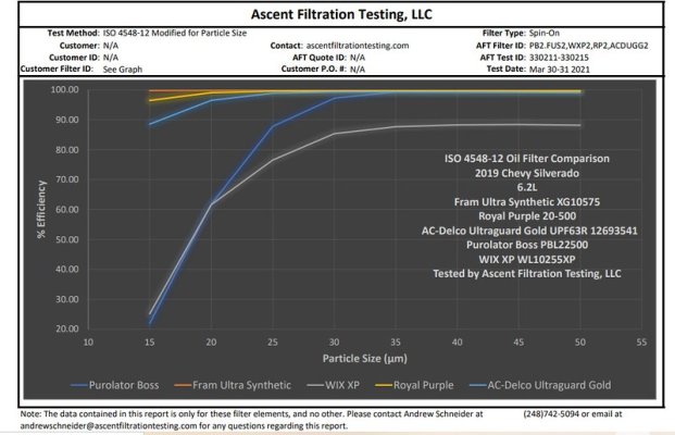

Treb, head on over to the oil filter thread. I'm into Fram Endurance these days, Royal Purple still has a following but they've ****** us around a lot on availability and pricing.
Fram Ultra was downgraded. Purolator Boss seems to me little different than Wix XP - a synthetic rock catcher?
I am going back to my stock of RP 20-820 and may pick up a couple Fram Ultra Guard after referring to this graph...

Look at that test date.
That was three years ago, these oil filters have since changed in filtering efficiency.
I thought I recalled recently seeing a YT video showing the PB performing well, but I don't recall what it was being compared to, and I didn't save it.
It's hard to find a test setup that features only the filters we are interested in,
and is recent.

Yeah, the efficiency was poor on the original Ascent independent test, not sure why the YT guy got a different, better result. So from my view, Purolator Boss is a rock catcher, without more recent data or explanation.
How do we know? Largely through forums like this one, cause manufacturers don't say much anymore. They're all about marketing and flack leading the way with no facts.
So we get industry insiders sometimes, independent testers sometimes, etc. For instance, there was a big hullabaloo when Fram cheapened Ultra and launched Titanium and Endurance. Took us a while to figure out what they were up to and why.

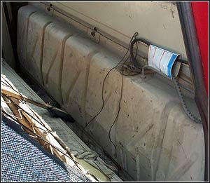

You will remember when all the pickups had their gas tanks squeezed inbetween the cab and bed. They thought that was the safest location. ha hahahahah
Inside the cab, behind the seat back in the 60s Fords and Chevys.
36 inches behind the ash tray, push-in cigarette lighter, and empty Busch light can!
