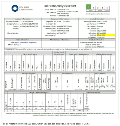

Would anyone run this oil in a PentastarView attachment 575910
Sure, why not? Pentastar is conventional valve train arrangement (non-Hemi), doesn't need a bunch of additives to bandaid lack of oil.
A nice, stout 30 weight, too. Being a 5W-30, it doesn't matter too much to have a bunch of shear-stable VII additive either (unlike 0W-30, etc.).

I would run that in a non hemi for sure, one of the better base numbers we have seen. But the fs euro is just as good plus Moly. Whatever oil was posted earlier I forget exactly. whatever Travis said.
