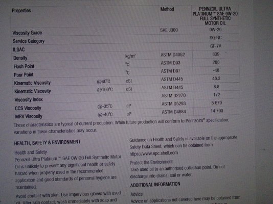

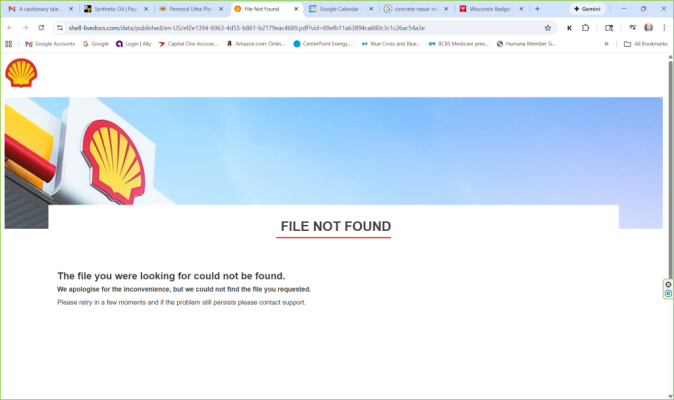

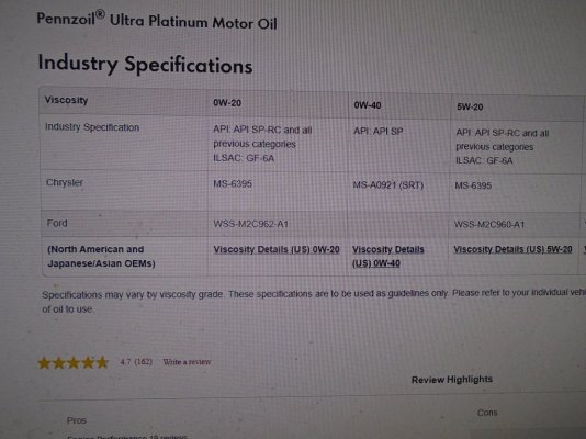

Someone show me where to find Pennzoil viscosity details on their site? If they took that down, never going to suggest that brand again.

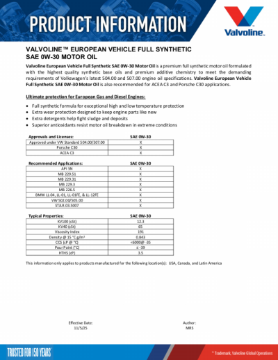

And another one, looky at Valvoline 0w30 euro and its big beautiful specs and visc (pdf). Can anyone find a voa on that?
Extended protection no 0w30 and neither does advanced, but that is where you find the 0w16 and 0w8 CR@P!!!
Seeing a trend here? We are all in on this thin stuff even more then euro trash man with this fake stuff, they must be laughing at us over there. As for that 0w30 euro valvoline, man that might be the best one I've seen for shelf oil or even amsoil. But all of them are built so stoutly.

From Valvoline, as you can see euro 0w30's ditched the notion of fuel economy..
The minimum High-Temperature High-Shear (HTHS) viscosity for 0W-30 oil depends on the specific specification, but a common minimum for certain modern, fuel-economy-focused oils is 2.9 mPa•s to 3.0 mPa•s. Older or more traditional specifications often require a higher minimum HTHS viscosity of 3.5 mPa•s or greater, such as ACEA A3/B3/B4. It is essential to consult your vehicle's owner's manual to determine the correct HTHS viscosity for your engine
As we all know there is a large difference between 2.9 and 3.5 hths, but also look at the cold performance on these oils. Maybe we should call euro 0w30's super class 0w30. Amazing stuff imo.
