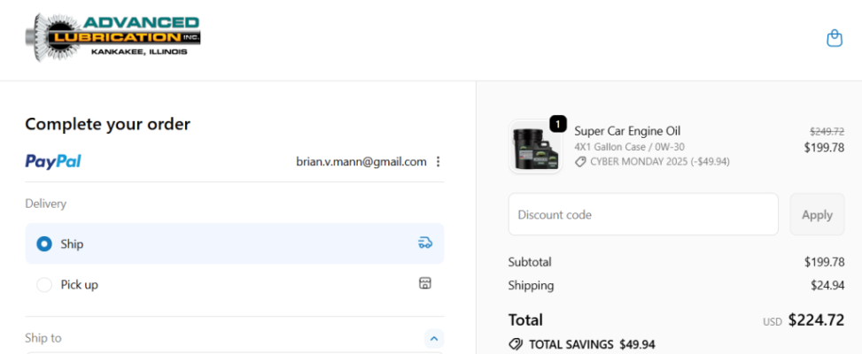

Ok guys & gals - HPL 20% Sale is on. I picked up a case of SC 0W-30 for $14 / qt including shipping. Discount is supplied automagically during checkout. I think the sale runs through Cyber Monday.
Go git it!
@Travis8352 - were you notified of the sale by having an HPL account?
