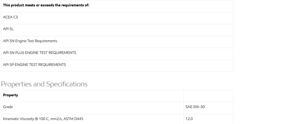

How can that legacy Ca/Mg antiwear additive "meet or exceed" API SP LSPI test? Yet Mobil claims it does in big, bold public print.
It has a bunch of Boron additive, though. I think @Travis8352 mentioned something about Boron additive being the new witch's brew recipe for antiwear without LSPI? The UOA poster didn't mention any engine knocking.
Viscosity didn't shear much under high BMEP, either @ 4,863 OCI, @ 11.6 cSt / 100C (spec sheet typical new is 12.0 cSt / 100C)
Mazda is very clear they want 5W-30 in the turbo motor (the NA motor calls for 5W-20) obviously for the higher BMEP. So I want a real SAE 30 wt, not watered-down API SP PUP 5W-30.

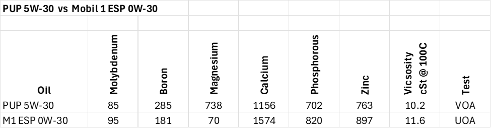

These are my VOA for PUP earlier this year, and the one you posted from BITOG of UOA for M1 ESP 0W-30, Mike.
IDK why this picture came in dark from a white Excel spreadsheet. I just typed the lab numbers in for direct comparison. Spec Sheet Vis for M1 is 12.0 cSt @ 100C.
Mobil's formula is to through more phosphorous and zinc in and leave calcium high and magnesium low. I have no idea how that "meets or exceeds API SP for LSPI".
