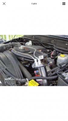

D43926E5-522A-4B07-A24B-0A9351CF603C.jpeg I contacted 2 local distributors.
Both were over 80 miles away. One was a cycle/atv sales-repair shop & the other was a small auto parts store in a small town.
Neither seemed really gungho about ordering the 5W-40 for me.
Both basically said with shipping or the gas I would use driving too either of their locations to pick it up would not be any cheaper then the Amazon price shipped too my door.
Sorry to say I’m not spending over $200 on Oil just to expect Free Shipping when I get it on every order from Amazon.
I will continue to run the Rotella T6 if they keep producing the CK-4/CJ-4 version.
If they switch to only the CK-4/SN version I will make the switch to Schaeffers or begin adding 8oz of ZDDPlus @ every T6 OCI.
The CK-4/CJ-4 Version of the T6 is a great diesel oil!
It’s the 10W-30 & 5W-30 diesel oils to possibly avoid CK-4/SN certification. (Very low ZDDP levels)! Not good for a powerful Diesel engine.
I just found a couple of 15W-40 oils & a 5W-40 oil that now carries the CK-4/SN cert. SOB!
I have plans on beginning a UOA program with Blackstone & the new 6.7L. I know they are not the most accurate but they are very accessible & not that expensive.
Then at some point before the 25K mile mark add this single stage oil by-pass kit!
With the Amsoil by-pass filter.
Need to create or find a different bracket which the filter is mounted vertical not horizontal.

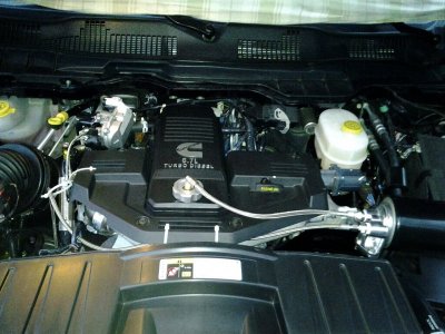

Look at that pretty shiny new Cummins

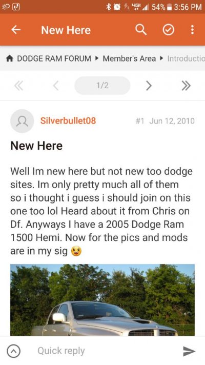

Ha ha ha !
Hey BBB , That link took me to a 2010 post here ??

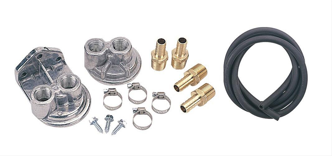

How much are those filters?
Catch the name on this filter kit? they named it after Syn.
Derailer kits are only 38 bucks, and you can add as many filters as you feel you want, just buy another kit, and better yet you can use factory filters instead of paying 50 dollars for a filter.
Every time you buy filters for a Amsoil bypass kit, you can have paid for an entire redline oil change, lol. That is 7 qrts plus a RP filter, same cost as two amsoil bypass filters.
7 qrts redline 70 bucks, add a rp filter 15 bucks tops = 85 bucks.
Amsoil bypass filters (not the kits) cheapest 40 bucks for the small ones which nobody would use (defeats the purpose) and 60 bucks for the large filters. 2 large amsoil filters = 120 bucks, what?
Considering how well the RP did in the filter thread test, I'm not sure I would bother with a bypass filter, but if I was I would get a derailer and buy two kits and still run double RP filters as opposed to paying 120 bucks for 2 filters, that seams crazy to me. Now if I had money to burn, then maybe it wouldn't matter so much, but you are looking at a 200 dollar oil change and that is dyi price.
just posting another option Sinister, don't vote me outta here.

I drove a Cummins for a decade, I was a member of tdr for my personal Ram, not many people buy the single bypass kit. If you want to extend the oci for a diesel a worthy goal, opt for a double filter system. Kinda tossing money away if you are just going to use a single filter. just say'n
