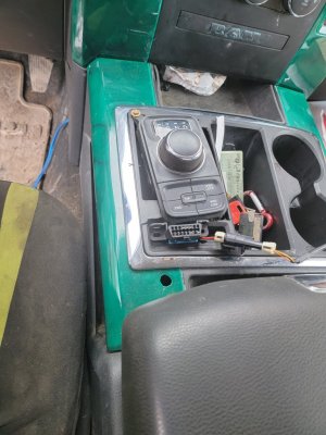

I had everything to put in the lower part of the dash but I'd have to cut the Das to make it fit plut re wire for the new style of heater controls . Which could be done but I didn't want to take the time to do it so I bought a center console and put it in there. Just so I could drive it now I'm going to 3d print or buy the console shifter out of a jeep or charger (new style ) to make it look and fit better. Don't mind the mess it's still my work truck haha

The two plugs you see there are for the tuning and code reading for the trans tcm again not pretty but not finished with the clean up job just yet lol
Function before looks Matt,if it works that's all that matters,lol.
Don't quote me on this,but i seem to remember Charles at Hellraiser saying the Jeeps shifter was a better fit in the trucks console then the cars shifter is,i don't remember why though.
