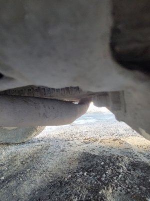

I did t have to change anything on my exhaust.
