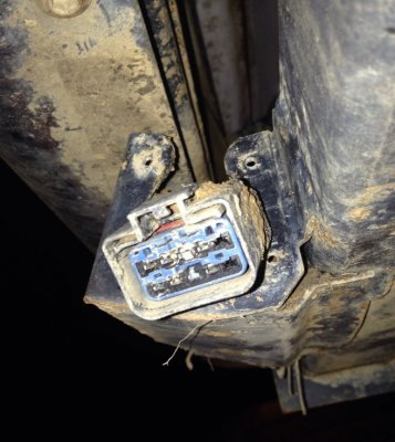

I just bought a 99 dodge ram 1500 I have the lights sockets and the wires coming from them but nothing to plug the connectors into? Also my factory trailer wiring looking funny didn't know if that could be were the harness went or what I'll enclose a pic of it just want to be able to hook up a 4 way trailer there . And I have the pig tails just no were to plug into wiring harness

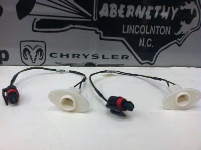

I have these to plug in bulbs but no pig tail connectors that I can find to plug in

Your first picture is of the connector for the stock 7pin trailer harness. Could probably pick up a new male end at a junkyard.
For the tag lights, they are there, I just don't remember exactly remember where they are. I will look tomorrow for you if no one else has replied by then.

Hard to tell, but it's possible. These trucks never had a 4 and 7 pin wire harness on them. The non-tow package trucks didn't have anything and the tow package had 7 pins. You had to use a 7-4pin adapter.

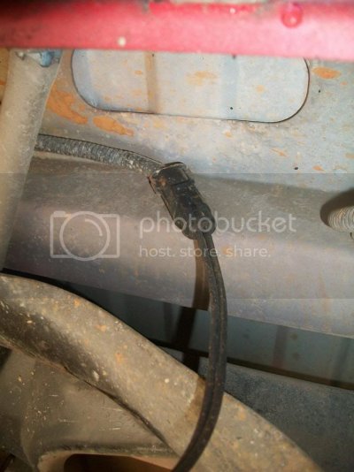

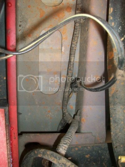

^Sorta. Hope these help
Driver's side
Passenger's side
Tow hitch plug
I wish I could have gotten better pictures of the tag harnesses for you but the truck is parked on dirt and it was raining ice from the trees on me. lol Hope these help you.

I don't that that wire that goes across. Or any plugs for the tag light wires to plug into. Can I hardwire them into each side tail light? All I have is one wire on each side running in the plastic loom down the frame but no plugs for them

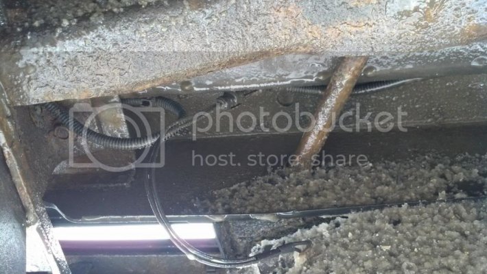

You might dig in the loom for the wires. Somebody may have stupidly cut the ends off.

Some photo's for you so you can start looking for the ends. Not the best photo's snow all under the truck was raining on me lol.
