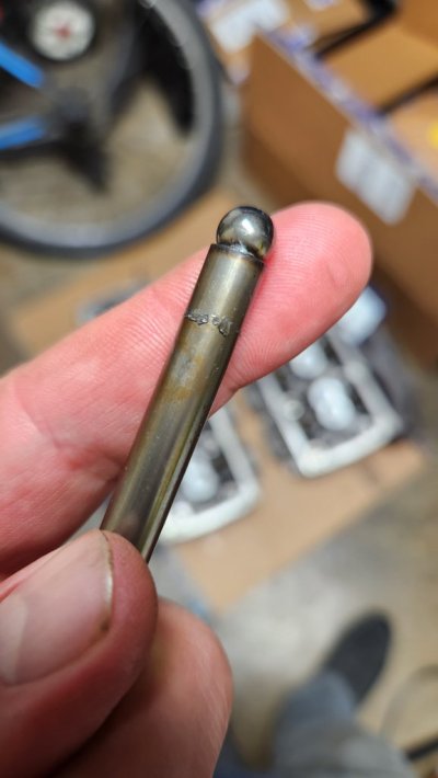

So I said that the lifters and cam looked new, and they do, but what are the chances that a lifter collapsed? And what does that even look like? I ask because trying to Google about collapsed lifters brings up a whole lot of GM stuff and almost nothing hemi related.
I tried to push a pushrod into all of the ones I took out and most of them are impossible to budge with oily hands, but the intake lifter for cylinder 8, where I heard the noise with the stethoscope, I can very easily move that one about 1/2 inch. There's like 2 others that I can get the spring to give with a bit of force, but the rest wont budge.
I'm tempted to try it with one of the new ones but they've been soaking for going on 2 weeks now and I don't wanna squirt the oil back out of them.
I can't find any spots on the heads that would explain those bits I found in the pan, so I'm just gonna tell myself it's from **** poor cleaning during the rebuild.
Also, the intake pushrods for 7 and 8 both look like this, which I can't explain. I kept them organized per cylinder, but not which end was which way when I took them out. They're all still straight, but I did order new ones.
I'm going to start the reassembly process first thing Friday morning and hope to have it all back together this weekend.
