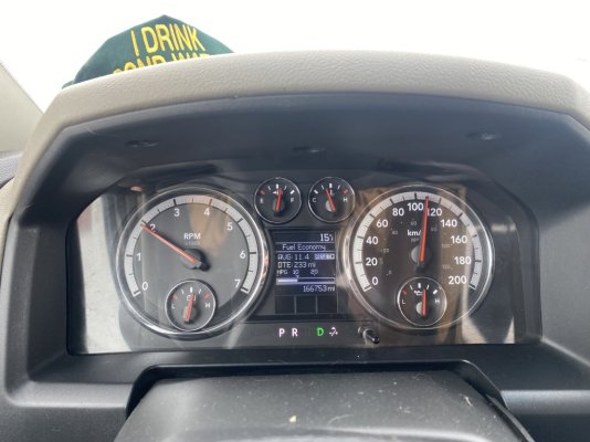

Had an engine code for a P0420. Took out cats and put in anti-fowlers. No engine light so far, but have noticed my fuel economy is absolutely terrible. Was bad before and now seems a little worse. It’s a 2011 Ram 2500 5.7L crew cab longbox 4x4 with 3:73’s and stock tires. I drive it like a grandpa and get 11 mpg on the highway. others seem to atleast get 14 but I just can’t. I’ve gone 150 miles with 35 gallon tank and I’m almost at half. Wondering what could be causing this, or maybe it’s normal and I’m overreacting. Any help would be appreciated!
(What the computer is reading on flat ground)

What do you think the stock mpg should be? You have a pretty good-sized PU.
I guess If it were my truck I would either take it in to a mechanic ...maybe a parts store will do a real good scan for you.....and get a good scan done. Are there any other codes? Is it running in closed loop? Are there any misfire counts (if so, how many?)? There could be a weak or bad coil too. What's the air temp sensor reading (voltage)? What is the coolant temp sensor reading (maybe it drifted). Is the air filter good/free? Maybe a rodent made a nest in the air box..
Have you done anything with the spark plugs? PCV? If I went to change the plugs I would also do a compression test (watch a video how), and record the vacuum.
Autozone rents these tools for free.
Verify no brakes are hanging up. Some tires are as much as 10lbs heavier than other tires ...and 10-ply tires can take off 1-2mpg.

Just put the scanner on the truck. Got a P0303 code (misfire in cylinder 3). Truck sounds fine though. Did have an engine code for low catalyst efficiency in bank 1 before I deleted the cats. Wondering if the bad fuel mileage could be the plugs carboned up from the bad cat.

If you just picked it up this morning,there's been a hell'va change in weather since yesterday.Today it's alot colder,and there's a **** pile of snow on the roads,that wasn't there yesterday.Cold tires and driveline also add into the faction today,that wasn't there yesterday Plus if you just filled it up in the last few days,we're on winter fuel now,all those scenerio's add up to kicking the hell out of your gas milege from 1 day to the next day. 11.5 mpg with a 5.7 equipped 2500 isn't all that bad for the weather and road conditions today.I don't think dropping the cats is your issues with milege,it's just the way it is at this time of year.Gotta love Canuckastan in the winter,lol
