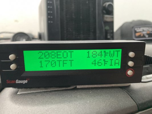

That’s a very good point. And somethin to think about. What’s the stock operating temp/thermostat for these 6.4 trucks? 205? 185? Or do u know?
RyckK
May 8, 2017
My normal/highest operating coolant temp was about 223 deg F (slightly below the Coolant Temp Gauge Mid Point on my truck). Temperatures would rarely/briefly exceed that even when towing. The 6.4 radiator has enormous cooling capacity.
Towing in below freezing weather the Coolant Temp would fall below 200 deg F and depending on ambient temperature could take well over 5 min to slowly climb back to normal before rapidly dropping again once the thermostat opened.
The winter front helped reduce the temperature cycling range and made a big difference in my towing gas mileage.
I guarantee you that’s hurting mine. I had a new radiator and thermostat put in at the dodge house bout 6 months ago and I recently got a scan gauge so I can monitor my **** more closely. And my coolant is always around 180 or so even when towing. I bet they put a 180 or the wrong thermostat in here. I usually do all my work myself, even big jobs. Rearend replacements and ect. But I had loads to run and used my back up truck and just put it in the shop to do it and I guarantee u they put the wrong one in here. Cuz my coolant RARELY sees 200.
I’ll be switching that out this week. Thank u for the insight brother.
Just looked it up stock thermostat is 203 in these 6.4s. 20 degree difference. I bet money my mpg will improve when I get it switched out.
