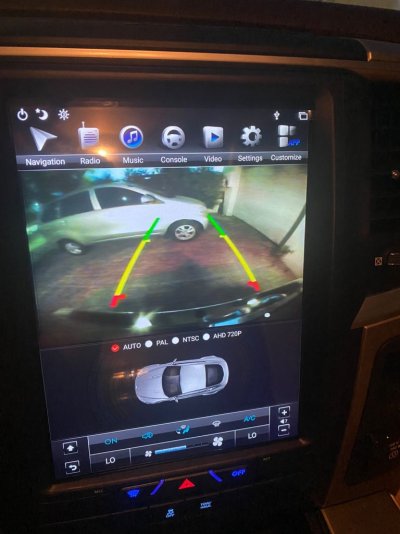

I recently purchased one of these head units from China. I like it. It is snappy and works well. After purchasing item, the seller contacted me and said that I needed to pay another 20USD for reprogramming, because of the kind of A/C in my Ram 1500. OK.. I found it odd, but accepted it.
When the unit arrived and I installed it, I was slightly disappointed.
WhatsApp Image 2022-04-07 at 7.03.35 PM.jpegWhatsApp Image 2022-04-07 at 7.03.36 PM.jpegWhatsApp Image 2022-04-07 at 7.03.35 PM (1).jpeg
I was hoping that the software would be tailored to the vehicle. Instead I'm getting these generic images showing when the car door is open and the image of what looks like an Aston Martin. I asked the seller if these can be changed and he said No.

Also, the reversing camera seems to be of a very low resolution compared to the crystal clear image I used to get with my factory 8" display. Would appreciate help in that area.
I'm not completely upset. These aren't deal breakers in me using the unit. I like the idea of using Waze on this.. It works brilliantly. I just wished for a little bit more attention to detail.
Is there anyone that can help me with getting my head unit to appear more factory?
1. I would like to change the vehicle icons to show the Ram or at least a truck.
2. I would like to get the camera to be more clearer.
3. Maybe change the theme a little.

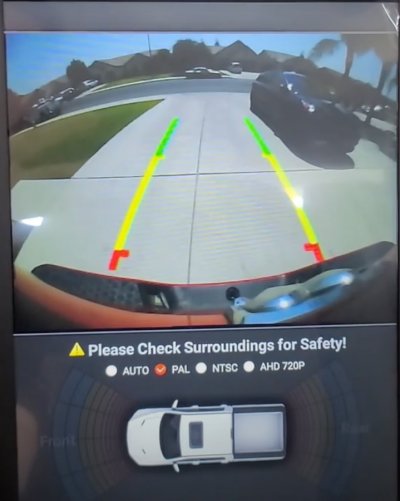

I had the same issue with the camera. The old camera and display were lower resolution, so putting the lower resolution on a higher resolution display doesn't look as good. I sold the factory camera and bought a fairly cheap one on Amazon that works great.

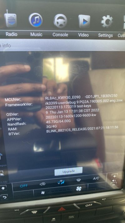

Thanks for the link. Yeah, I'm in contact with that group already. The guy as for a screenshot of my system details. Turns out my unit is 1600x1200 resolution and he doesn't have a firmware for it.
When he mentioned the resolution, it was then that I understood that my 8" screen was from 2014 and probably not of great resolution, hence I guess the camera image was also not a high resolution cam as well.
I guess I will have to live with that part. As for the icons, the guy on the group said that he was working on firmware for my unit and will let me know when it is ready.
I happen to know that the answer is false as if I would have bought the unit from Phoenix or Linkswell, I would have this..
Clearly that is a Ram.. and the other icons in the youtube video were also correct. I'm pretty sure that both Phoenix Automotive and Linkswell do purchase their units from the same factory. So how do they customize the logos on their units?
That's actually an excellent resolution for that size screen IMO, however, it seems to suffer from reflection and low brightness, unless you just don't have brightness maxed out. If I remember right, the originals were only 1024x600 or something really low like that.
When I took the picture, the brightness was set low. Now it is up. All in all, I'm happy with the unit. For the moment, I'm just going to keep it as is and be content till an updated firmware is released on that facebook group. The guy does know what he is doing and frankly, I think his work is a lot better than what Phoenix or Linkswell are offering.
