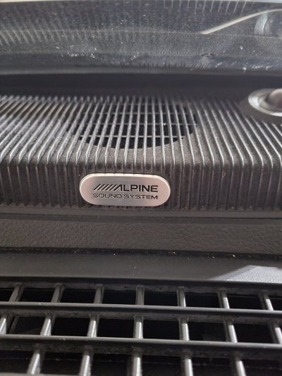

Factory Alpine system has a center speaker top middle of dash panel & has an Alpine badge.

Thanks, finding a compatible Tesla unit with that sound system has been challenging.
The seller will give you a different harness to make it compatible with Alpine systems.

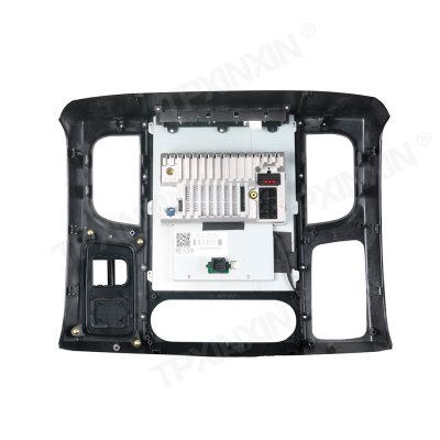

I have a 2017 Ram 1500 with a 12.1 PX6 4/64 HU installed, back of unit pic below, i want to install a 7 keys wireless steering wheel smart car remote control button pic below. Factory wiring diagram does not show a "Key1 or SW1" wire on factory wiring diagram. I think steering wheel volume control signal comes over Can Bus to OE radio. Does anyone have a wiring diagram for this head unit? Or hooked one of these Volume control remote in a 2017 Ram? If so I would appreciate any info you may have Back.jpgVolume.jpg
