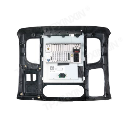

I have a 2017 Ram 1500 with a 12.1 PX6 4/64 HU installed, back of unit pic below, i want to install a 7 keys wireless steering wheel smart car remote control button pic below. Factory wiring diagram does not show a "Key1 or SW1" wire on factory wiring diagram. I think steering wheel volume control signal comes over Can Bus to OE radio. Does anyone have a wiring diagram for this head unit? Or hooked one of these Volume control remote in a 2017 Ram? If so I would appreciate any info you may have View attachment 494358View attachment 494359
I would recommend installing the OEM steering wheel controls instead or buy a new steering wheel with factory controls. They will work with the PX6
Adding to this ... Switched 12v can be found at the 12v dash outlet below the radio

Adding to this (even though this thread is not about your aftermarket radio... There are other dedicated Tstyle threads) ... Switched 12v can be found at the 12v dash outlet below the radio
Switched 12 volts is not the problem...volume control wire going to the T-Style HU is what I am trying to find. Sorry posted in wrong thread, My mistake feel free to remove.

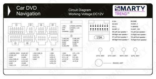

I have a 2017 Ram 1500 with a 12.1 PX6 4/64 HU installed, back of unit pic below, i want to install a 7 keys wireless steering wheel smart car remote control button pic below. Factory wiring diagram does not show a "Key1 or SW1" wire on factory wiring diagram. I think steering wheel volume control signal comes over Can Bus to OE radio. Does anyone have a wiring diagram for this head unit? Or hooked one of these Volume control remote in a 2017 Ram? If so, I would appreciate any info you may have. Thanks

I have steering wheel controls, wife wants a knob.
You fool! No good can come of this!
But I'm pretty sure all steering wheel function is signaled over CANBUS, even the horn.
That's true it does come over thru the can buss, but it has to enter the head unit from can bus...that's the wire I am trying to find.
Put your truck info in this site and search "radio c1" (I think?)...that should give you the connector wiring diagram and function.
I have wiring diagram for truck, can bus decode module is inside factory radio, The aftermarket Android HU has a external can bus module. Wiring diagram from aftermarket external can bus module to android HU is what I need.
I do have an extremely low res wiring diagram that did work for me to identify speaker wiring. Maybe it will help...
Maybe instead, identify the CANBUS signal wires in the factory harness from that website previously posted and try to trace those wires/pins to the external CANBUS module in the T-Style radio harness then on into the radio (if needed).

I wouldn't try to rely on any CANBUS wiring diagrams you may find for these radios as they are used in A LOT of different makes/models worldwide. Instead, identify the CANBUS signal wires in the factory harness from that website previously posted and try to trace those wires/pins to the CANBUS module then on into the radio.
I do have an extr
Thank You

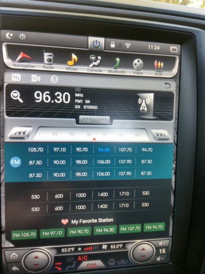

I can't comment on performance as this was done using a buggy Iphone 5 but here is a picture.

Q: Does wireless Apple Carplay work? If so, does it need the wireless dongle for it, or is it just built in?
A: Not natively but I would think the wireless CarPlay dongles would work in the same way the AA ones do.
Q: Does the AM/FM radio display song & artist info?
A: I believe the answer is no unless they have done some updates since last I used it (see picture)
