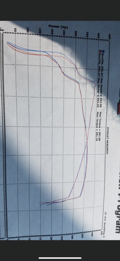

I got my long tubes & hi-flow cats/y-pipe installed by Quick-Shifter, had a custom tune done-Hp tuner done at the same time. The tuner told me should be about 420hp, to get any more would need to upgrade the cam. I believe the throttle sensitivey can be adjusted with the custom tune. I had my idle turned up to 750,there are lots of things that can be adjusted/ changed. I’m extremely happy with the outcome & my truck is running great!
