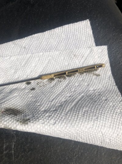

I noticed it when the truck was idle. I'll pay attention to see if it happens while I drive too.
I checked the engine oil level, it looks like there's oil above the "safe" marking. Could the problem be that there's too much oil in there?

Too much oil can be very bad on a gasser and I'm guessing in a CTD it can be just as bad, but how much over is it? Are we talking an 1/8" over the fill mark or half way up the dip stick?

@Loudram it may be difficult to see on the picture, the entire plastic part is covered in oil. The oil reaches about 1/4in into the metallic part.

It is only a problem if there is so much oil the crank is sitting in it, I appears you are border line. It wouldn't hurt to loosen bolt and take a qrt out. "IF" the crank is sitting in oil it could cause this in theory. allthough I'd expect the worst sounds just at start up if this was the case.

I had to take the truck to the dealership for an unrelated recall and while I was there I asked them to take out the extra oil. Turns out there was one quart over filled.
Since then I have no longer heard the ticking noise. Thank you everyone for your help!
