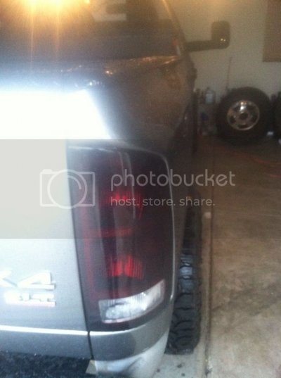

So i don't have the money to buy the highend tail lights so i thought i would do it myself. What do you guys think?

needs some clearcoat and a polish - but good stuff!

photo.JPG Here is what clearcoat, wet sanding, and polishing will make em look like for just a few more dollars and a little time. They look good on ur truck. Nice job.

yeah definitely add clear, wet sand, and polish. turns out amazing!
I did mine myself also. used three coats of nightshades, three coats of clear.

what kind of polish do i need. i did the wet sand and put something on after that. the lights are very smooth to the touch now, they just aren't shiny.

are they clearcoated?

I wet sanded them with the 2000G sand paper, i used some paint thiner to help clean it off. Then i used Rust-Oleum Lens Tint (they didn't have night shade) but i think this stuff worked great. After i was done with that (3-4) coats i put Rust-oleum Ultra Cover Gloss Clear for plastic for the clear coat, (3-4) coats as well. took the lights back in an wet sanded VERY softly to make them smooth witch they are. then i used Meguiars Polishing Compound to make them look good. I think they look good and i am very happy with what i did espically seeing how i suck at this kind of stuff lol. Do you think getting the Krylon Clear Coat would make them pop a little more. What do you guys think.

Looks good man! I think the matte finish matched the PD'd Rams Head anywho.

Mine turned out with a similar finish as yours. I buffed mine for a good 15-20 minutes each and got them a bit more shiny.
But you're using the right stuff, Meguiar's Ultimate Compound. Get you one of those circular microfiber pads and go to town on it.

@ Musclemckeester, i will put some more meguiar's on it and see it if helps. I love the look so its not a must do thing, more of a touch up thing.
