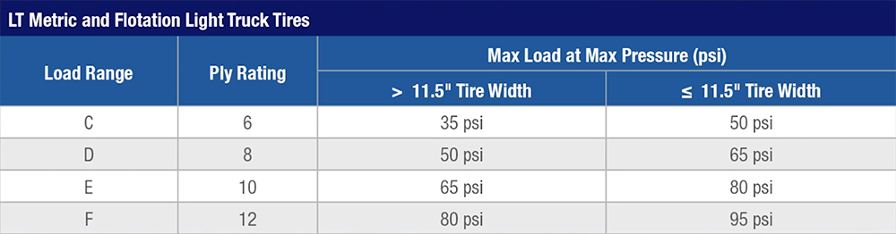

Load E's have a longer range of psi, you can run them low or high, really high well over 50 psi. But for oem load c stuff that 40 sounds a tad high unless they are thick. If they are load d you are good, check load rating. Now the problem really comes with load, just town driving whatever, you start towing heavy or carry 1500 pounds in the back, follow recommendations in chart.

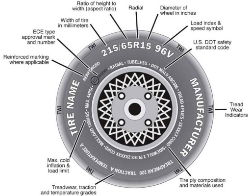

On the tire it says 'Extra Load' but no load range
It does say rated at 2756 lbs 116 H at 50 psi max
What does the '116 H' mean

Checking the door sticker is not always accurate if the tires have been changed.
Look at the sidewall of the tire. They have load ratings and tire pressure info. It's usually in fairly small lettering near the rim, like this.
