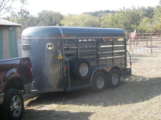

They be fine for my needs. Like towing a trailer through a hay field, and such. But I run a stock truck, stock height. They did real well in Feb 2021 snow storm of 8" plus ice. I found I did not need "E" rated as I tow infrequently except to take Hoss somewhere and go and buy hay, get stuff from Home Depot, things like that, which be why I have my trailer for hossies and home stuff.
Trailer 14' X 6', stock, WW, 2150 lbs dry, dual axle, electric brakes.
