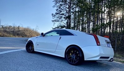

Wouldn’t get a dime for mine how it sits now plus it’s paid off. Also just picked up a CTS-V, so not crazy about a new truck note to boot lol.

NICE!! What year CTS-V?? Pics?
