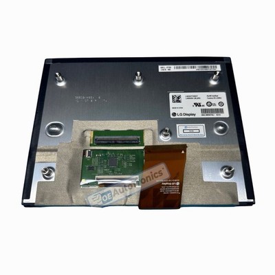

Can you point us in a direction to get a new screen ? Clueless on what to look for .
Their are three revisions
SL01
SL02
SL03
The part number revised to correct delamination is LA084X01 SL03. Those cost the most. If you search for that number you will get all part numbers. Anything under $200 is likely not an SL03. There are also many counterfeit screens now that likely work but are not made by LG.
If you find one you think you want to buy, feel free to post the link here and I'll check the listing to tell you what it is

That looks like a good genuine LG part (the knock offs have weird conterfeity white labels on the back that are meant to look like the LG label but aren't). If I were looking for an SL03, I would buy what you found.
