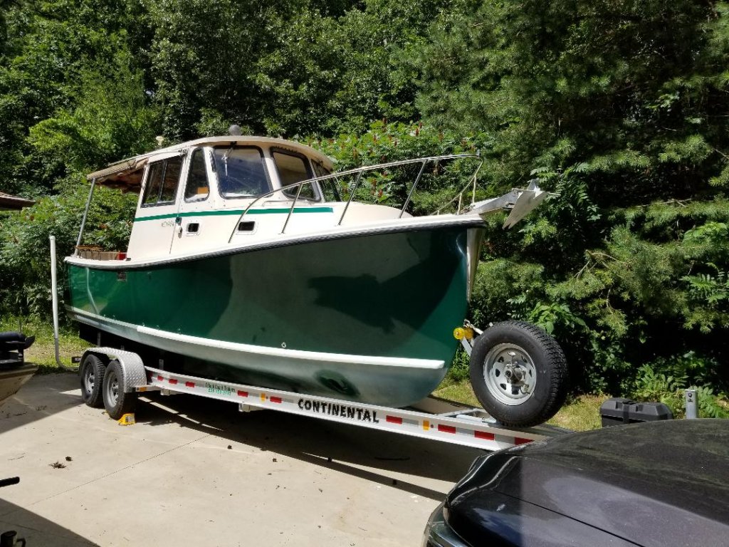

I see, thanks for clarifying. I appreciate the info from all of you guys! I added a picture in post number 9. Boat sits on trailer a bit over 12 feet high - and has a bit over 4 feet freeboard on the bow. That pic does not have radar yet.
Bob
