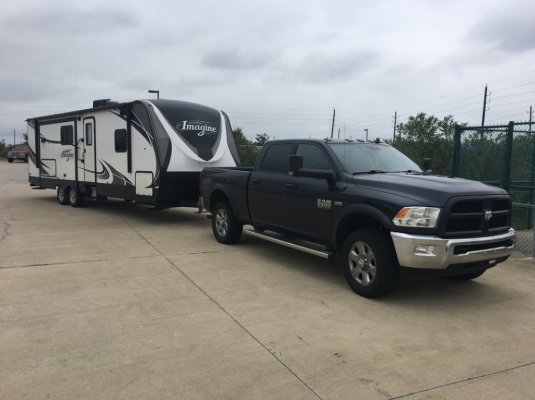

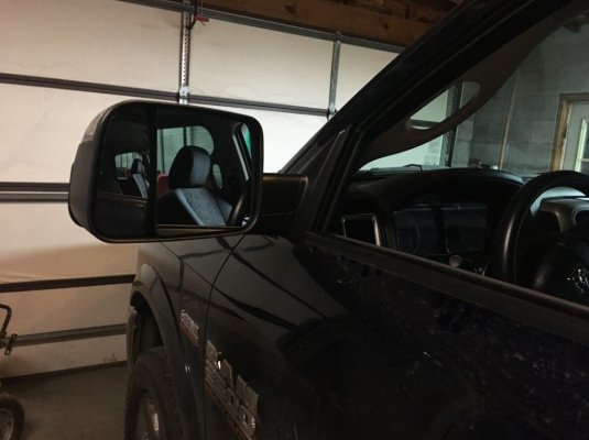

Here are pics of my Trail Ridge. We have no complaints or issues. My step-son just bought a set for his 2020 Tundra too and likes them.
Sons truck

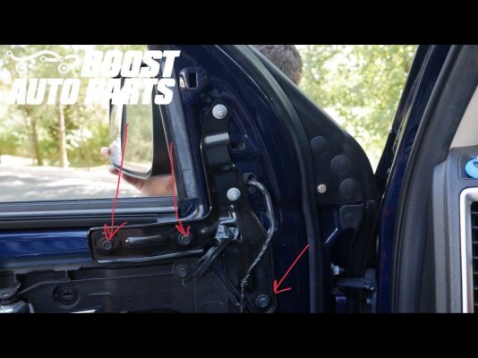

The brackets are an OEM item you can get through the dealer, or online at someplace like moparwholesaleparts.
Those brackets are necessary to support the towing mirrors and provide additional bracing especially because you pivot the mirrors up and down which places additional stress on the mounting holes.
Make sure you also get the rivnuts and bolts necessary as they have to be installed in three places in each door to anchor the brackets.
Look at items 9,10 & 11 for part numbers on this page...
You need a left and right bracket, 6 rivnuts and 6 hex head screws total...
