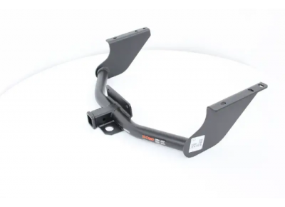

When i got my 2016 Ram 1500 Bighorn
It came with the Class 4 hitch receiver & Integrated Brake Controller
I guess there are options for anything
I think that the Hitch Receiver was built by CURT for Ram
Etrailer carries Curt Hitch Receivers at a reasonable price & they are easy to install with 2 people
I can't stress strongly enough, Using just your bumper & a hitch ball is an accident waiting to happen, the bumper is no where close to strong enough.
Even a Class 3 hitch receiver bolts both to bumper & a cross member
Class 3
Class 4

The bumper is rated 500 tw and 5000lbs trailer.
There is a solid steel mount where the ball goes.
The issue is...it is only one height and not many trailers can be attached that high.
You would not have the square tube to put a ball mount into
You would nit believe the number of people who did not walk to the back of their truck to see if the class 1V receiver was there and then blamed RAM for forgetting it.

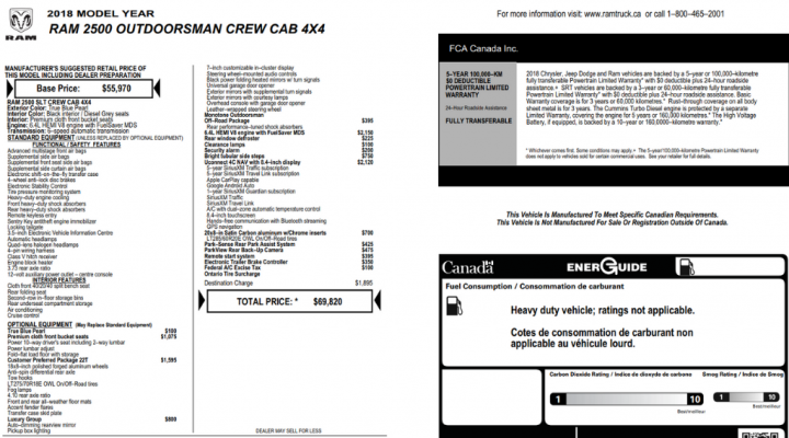

Well I just looked at my window sticker and it doesn't specifically sat 'Tow Package' but has the Class V receiver, engine oil cooler, 7 and 4 pin plug, factory trailer brakes, etc. Mine did not come with tow mirrors
