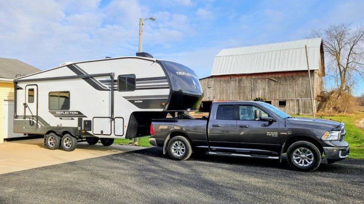

Agreed - nice write-up.
I have a 2019 Ram 1500 Classic Quad cab, 6'-4" box, with the factory trailer-tow package. When I first got it (brand-new) we had a 6300# bumper-pull 25' travel trailer. It pulled it fine after the first trip. Curiously, I was not able to order decent tires with the trailer tow package, and the first trip the rear end squirmed all over the road with the 'standard load' cheapie Goodyears it came with. (My wife was even getting motion sickness!) At 1500 miles, I replaced them with Wrangler All Terrain Adventure with Kevlar, load range E tires, and the squirm went away. I also installed AirLift air bags in the coil rear springs - made a huge difference in stability. You can inflate them to 100 lbs; never had them more than 25 lbs.
In 2023 we 'downsized' a bit to a smaller, 22' and 4500# travel trailer, which it also pulled fine. After my wife joined me in retirement last November, we decided to travel more and traded in the 22' for a 25' 5th wheel at 6500 lbs. (We'd had one years ago; loved pulling them.) I had to inflate the air bags to 40#, but other than that, the trailer pulled quite well - though the 5.7 Hemi got a whole lot more thirsty. (9 mpg average on a trip from MI to FL vs. the 11-12 mpg average with the smaller RV.) Going over the 'mountains' in Tennessee and Kentucky, the 8-speed transmission (in Tow Mode of course) did a great job keeping my speed at the posted 'downhill, 4% grade' limit of 55 mph - never had to tap the brakes once. I need to pull onto a Cat Scale and see what the CGVW of the trailer and truck is, but the RV manufacturer supposedly designed this 'small' 5th wheel (a Grand Design Reflection 22RK) to be 'half-ton towable.' The hitch weight in the box is 1100#; the tuck's VIN indicates (on one of the many towing guides available on the web) the payload is 1890#, and the CGVW rating (with the 3.21 gears it has) at 13,900 lbs. RPM's going up some of the grades climbed to over 3500, but mostly it towed it at 65 mph at about 2700 RPM. (The previous trailer would pull along at about 2300 RPM.) Don't THINK I'd need a 3/4 ton/2500 Ram, but might consider it. Thanks for reading this!
You do NOT have 1890 lbs of payload. Always check your door sticker, that's the "authority", not a towing guide which does not account for the features/specs of your specific truck. When you add running boards that didn't come like that from the factory... another 50 lbs off your payload.
So you're overweight. After climbing in with you and your wife, say 150 lbs each in a truck which probably only has about 1300 to 1400 lbs, then add cargo and your pin weight will be heavier too once you load it up.
Not trying to tell you what to do, but you have some bad math going on there which you may not be aware of.
Thanks for the feedback. I DID check the sticker when we were looking into the RV. That sticker lists the same weights as the PDF file I got off the Stellantis/Ram website reflects. Admittedly, they may 'pad' one or the other, but the GVWR is the same on both. There is no specific 'payload' listed on the door sticker, (though it's clearly reflected on the file I got from the Ram website) but the other things seem to match up. (e.g. - front and rear axle ratings, tire types, etc.) As noted, I want to get it on a Cat Scale and see what the combined weights (truck and trailer) are. We pulled the trailer from MI to FL with no issues earlier this month - lots of power, and the temps and pressures for coolant, transmission, oil temp and oil pressure are all within the normal ranges.

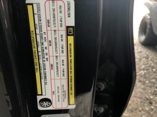

So the payload value is on the yellow sticker. It doesn't say "payload", but it will say "the combined weight of occupants and cargo should never exceed 680 KG or 1500 LB". The "1500" value is what you're looking for to get your available payload in pounds.
A cat scale is a good idea if you can isolate the rear axle, but it's not the GCWR that will be a problem in your case, that trailer is light enough from a "total weight" perspective, it's just the pin weight that's going to be a problem because 5w's put 20% to 25% of your trailer weight on your truck, a similar weight travel trailer will only do 10 to 15 percent... so the same weight trailer travel trailer is going to be much easier on the back of your truck.
Below is what the "payload" sticker looks like for a random ram 1500 I found on this forum.
Again, not trying to be a pain, just trying to help in case you're not aware of it all.
