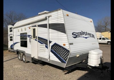

I have a weight distribution hitch. Supposedly the trailer weights 5300lbs but the title say3000.
I’ve searched everywhere for the true weight, but still not sure.
I was under the impression that my truck could tow up to 8400lbs.
Is your trailer a 2008 Forest River Sandstorm 24SKSPL?
