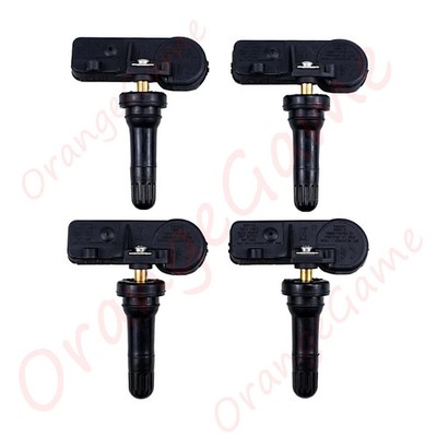

I have a 2019, Gen 5 ram, and just bought sensors with numbers matching the original part number. I watched a video, then broke down the tire and replaced the battery portion of the sensor. Put the tire back on after airing it back up, then drove about 10 miles and the sensor started reading again. The DT truck, gen 5, has self learning sensors! They do not get programmed. Here is the part I bought. https://www.amazon.com/dp/B0F8PVRF6R?ref=ppx_yo2ov_dt_b_fed_asin_title
Hope this helps.

You can buy genuine Mopar sensors on Ebay for $11.00 ea. I bought a set of these and they work fine.
