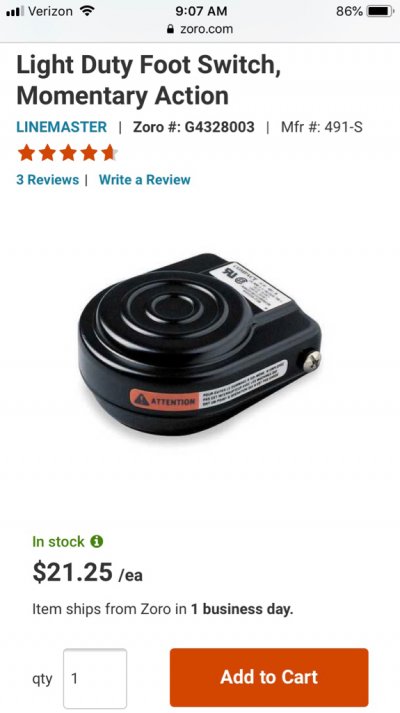

I'm planning on getting a set of train horns hopefully this year. My plan is to use a momentary switch like the idea of a dimmer switch I can use with my left foot. That way if stuck in traffic hopefully no one will figure out where its coming from :)

Mounting it on the floor is not a bad idea. Fab up a little mount for a horn button and maybe use some sort of velcro material to adhere it to the floor carpet in the area where the headlight dimmers were at one time.
