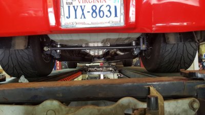

By far the easiest swap is the 46rh. The trans bolts to the hemi. The adapter flexplate to use a 46rh converter is around $100. Will need either a 05 manual starter motor or 46rh starter. Floor shifter for 3spd auto. Cross member needs the mounting holes elongated about 3/8". Original driveshaft fits. I recommend a full manual vb and two toggle switches to operate the OD and LU. I use a 05 manual pcm without issues. The automatic pcm can be flashed manual or left alone depending how clean you want your dash. Build or buy a trans that wiill hold your horsepower and select a converter you like. I use a custom built 9.5" billet converter with 3500 stall. 31"x16-15" tires (3:91 gear) and use 2nd and 3rd or just 3rd on the street.20180627_094507.jpg
