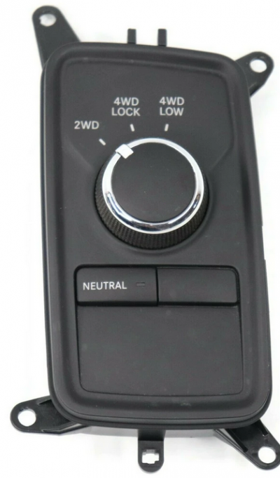

Image 1 44-44 ? with the auto button
Image 2 44-45 ? without the auto button
Which transfer case controls are for
a 44-44 ?
a 44-45 ?C6EC2C23-DE22-4128-8C99-E7525EA9B862.jpegB4F982CB-7B15-4975-AA50-5868AD2C44AD.jpeg

The BW44-44 uses the Auto 4X4 button, the BW44-45 does not have the Auto option.

The pictures show the trans shift knob, and not the transfer case position. Am I missing something with these pictures ?

When you enlarge the picture the T case buttons are visible.

Top picture has AUTO (BW 44-44).
Bottom doesn't have AUTO (BW 44-45).
Out of focus pics. Hard to tell...
