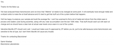

Blackstone actually recommends a purge due to excessive wear-in particulate. I'll probably do a gallon dump and fill 3 consecutive days since Maxlife is only $18/gallon. The total sump is 8 liters from my research so that should be a solid clear of the Mopar/ZF "potion".
