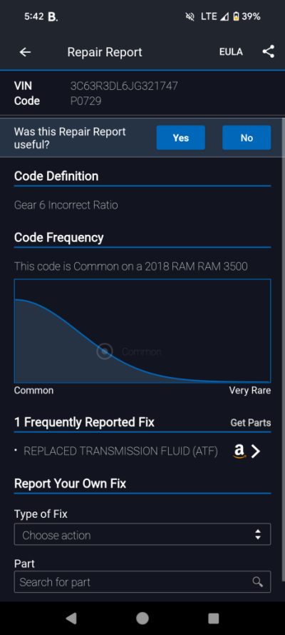

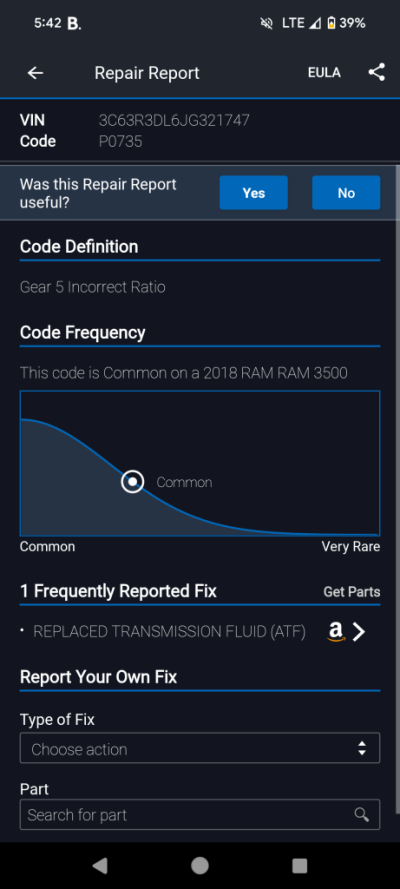

2018 Dodge 3500 Cummins. When accelerating it starts in 1st gear then hops into 4th gear but won't go anymore than that. The ATF is to its proper level and still it's red colour. Also when shifting into reverse or drive it jumps a little. Not sure what's up with the truck, as I'm young and new to this stuff. I used my blue driver and below is what I got for issues relating to the trans. Any solutions y'all got would be awesome. 1000005887.png1000005888.png

First/Fourth gear is limp mode.... the tranny has detected problems and is protecting itself from further damage by sticking to those two gears. The problem isn't first/fourth gear.... that's the symptom and by design. Get it to a shop.

Is the truck stock, or has it been deleted/tuned. Before limp mode, did you feel slipping when the truck shifted into 5th, 6th gear?. Might want to drop the pan and look for metal or excessive clutch material on the magnet (gray goop covering the magnet), if you are unsure of the service history
