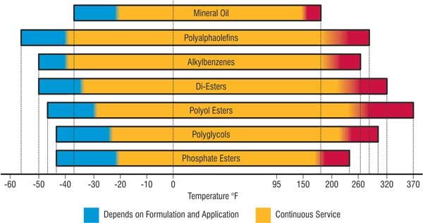

BTW, of course the zf runs hot, thus the need for base oils that handle heat better. So before you use atf4 you should consider what will happen long term with hot running temps. First line below is something you will see in most atf's, the second line base oil is what you find in zf fluid, so as you see in it's natural state it can handle the temps, which is the reason they say it is a lifetime fluid. Of course I don't believe it is a lifetime fluid, but each owner will have to make their own decision when to change fluid after considering everything. zf fluid great cold and hot performance.
