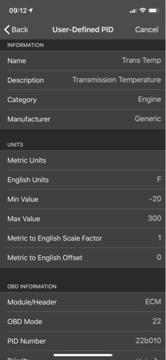

Tried the above, didn’t work. Could be app related or year maybe. Here are my screenshots:

My OBD header is set to auto and yours says ECM. Also looks like you have spaces between the ) + B( but don't think that matters? In torque pro it will give you a green check mark if the equation is correct or at lest in the right context.
