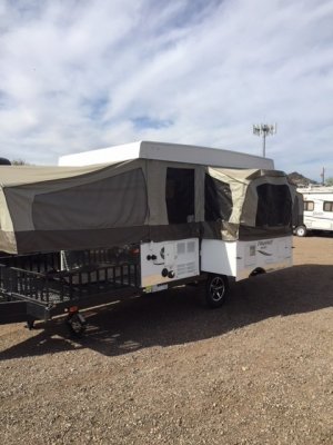

Here's what we have. 23' (19' closed) pop up, 3600lbs wet, (4300 with the quad on front), and it tows like a dream. Electric lift, so no manual cranking it open, it sleeps 6 comfortably, and has a 4' deck I can throw my quad up on front. The only draw back is you can't pre load it with your gear, ya have to haul coolers, etc, in the back of the truck. It's never really be a problem for us though. We bought this to see how much we'd go camping in reality, which turns out to be a lot less than what we imagined we would be doing. When life slows down a little, and we get to use it more than 4 or 5 times a year, we'll look at getting something grown up. lol.

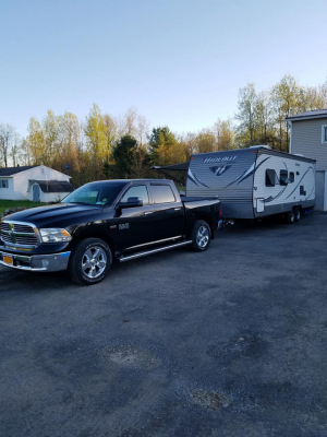

2015 Keystone Hideout 260LHS. 29'11" rear to hitch. 7600lbs GVWR. Dry weight: 5158lbs, 26ft for the shell.
2018 Big Horn 5.7 Hemi, 8spd, 3.21 gears.
Does fine with the Curt TruTrack WHD.
First outing with it, the trailer was weighing in at about 5520lbs.
