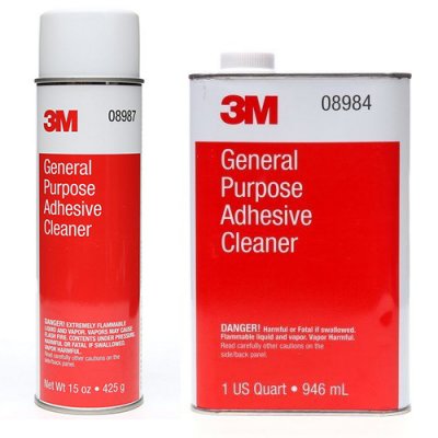

I've used 3M Adhesive Remover to get sap off of my vehicles with good results. It won't mess up the clear coat. Just use a microfiber towel when wiping it off.
