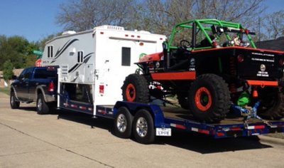

OP, honestly, I would go with something like this. Hauling a JK or anything similar that won't necessarily fit into a toy hauler but you still want a nice place to live/camp is something like this. 1 ton truck, gooseneck trailer, truck camper and JK. Tell your wife the trailer has multiple uses and the truck camper has a nice sitting deck on it too.
Do a google image search of "goose neck truck camper". Lots of good ideas come up.
