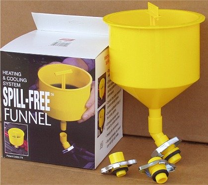

I agree, drips out of the water pump, bleed hole or not, are not normal. I don't know anything about the 'special' yellow funnel, but if you have all the air bled out of the system, which is unlikely since you say it is still leaking, I'd say the thermostat is in upside down.
Which side is supposed to go into the intake manifold, spring-side down or the opposite?
This is the funnel I use to bleed the cooling system in cars. It basically slowly releases air bubbles in the cooling system
