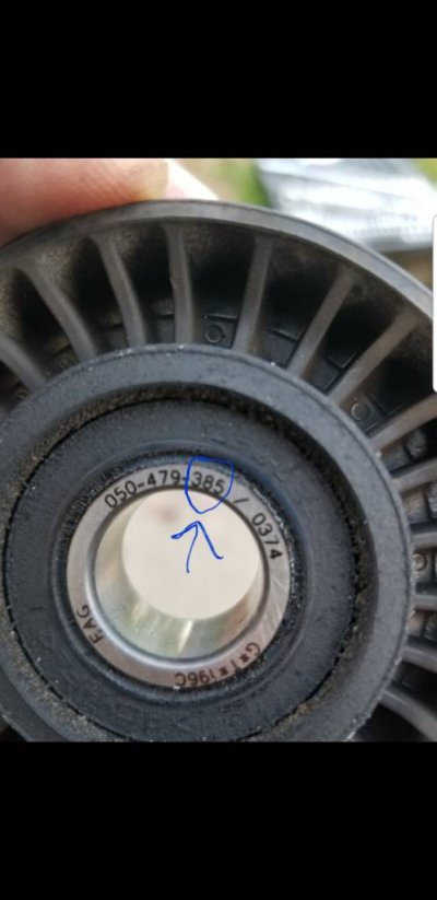

So it turns out it was the idler pulley. Job took less than an hour, hardest part was reinstalling the belt. (Getting under the truck definitely helps to reinstall it)
Here's what I did :
Remove the serpentine belt
Remove the idler pulley
Installed new idler pulley
Reinstalled old belt (looked brand new)
Here's some pictures :
Feel free to ask any questions... So glad to have that metallic whining gone! 69ee8aade8620d68d69bf72a35db45f9.jpgcf806ffc9aaebc0a0a1f0b4f46609228.jpg220a09f2cc05975ca6a4db74f0026932.jpg778437eb2f7e00607196166a355032da.jpg
