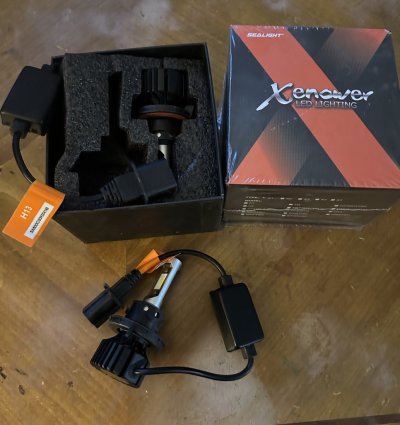

Has anyone used these. They won’t work on my 08. They’ll just flicker for couple seconds then stay off. Is there a way to get them to work?

Do these lights have built-in resistor's in the harness? If not, you will need to add them by using a 50 watt 5ohm resistor to make them work properly.
If they have a built-in resistor in the harness and they still flicker I would contact Sealight customer service for some support.

You would think that little black box inline would be the resistance, but maybe not.
