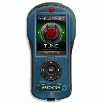

Whats the differance between the two?

Not much if anything except the form factor. Same tunes, same process to upload to your vehicle, both can be updated via your computer with a USB connection, etc...
I3:
Predator 2:

is one just a newer version of the other? I notice the blue one is about $30 cheaper

The P2 is a single vehicle only and doesn't have the touch screen. If these had been out and on sale when I did my PCM swap/I3 Platinum purchases on sale I'd have 2 P2's instead of 2 I3s (Ended up being cheaper with the sales than actually using the multivehicle I3 licenses). Also the touch screen is pretty meh so personally I'd go with the P2.

Not really. The original programmer for the MOPAR Hemi engines was the Predator. It was introduced sometime in 2007 IIRC.
The programmer evolution kinda went like this:
1. Predator
2. Trinity - production continues to this day
3. InTune
4. InTune 2
5. InTune 3
6. InTune 2 Platinum
7. Trinity Platinum
8. InTune 3 Platinum
9. Predator 2
Again, the current models are all pretty much the same with respects to the canned tunes. Some user features and tune modification options might be different as you move forward in time and up in model.
I'd suggest you go to their website and look at the difference between the I3 and the Predator 2. Also, keep in mind that any current generation programmer with the "Platinum" designation will accept custom tunes.
